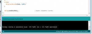

Спасибо всем за ответы. Накидал код , делает всё что надо но как то по дилетански получилось и расточительно к ресурсам....
думаю как бы красиво сделать :)
#define SENSOR_PIN A5 #define VAR_REZ A0 int latency=1000; int led = 13; int ledState = LOW; int average = 0; int a=0; int b=0; int c=0; int d=0; int e=0; int f=0; int g=0; int h=0; int i=0; int j=0; void setup() { Serial.begin(9600); pinMode(led, OUTPUT); } void loop() { delay (latency) ; int lightLevel = analogRead(SENSOR_PIN); int sensitivity = analogRead(VAR_REZ); int y = map(lightLevel,0,1023,1,100) ; int x = map(sensitivity,31,955,1,100) ; int a=(x+y); Serial.println("a"); Serial.println(a); delay (latency) ; lightLevel = analogRead(SENSOR_PIN); sensitivity = analogRead(VAR_REZ); y = map(lightLevel,0,1023,1,100) ; x = map(sensitivity,31,955,1,100) ; int b=(x+y); Serial.println("b"); Serial.println(b); delay (latency) ; lightLevel = analogRead(SENSOR_PIN); sensitivity = analogRead(VAR_REZ); y = map(lightLevel,0,1023,1,100) ; x = map(sensitivity,31,955,1,100) ; int c=(x+y); Serial.println("c"); Serial.println(c); delay (latency) ; lightLevel = analogRead(SENSOR_PIN); sensitivity = analogRead(VAR_REZ); y = map(lightLevel,0,1023,1,100) ; x = map(sensitivity,31,955,1,100) ; int d=(x+y); Serial.println("d"); Serial.println(d); delay (latency) ; lightLevel = analogRead(SENSOR_PIN); sensitivity = analogRead(VAR_REZ); y = map(lightLevel,0,1023,1,100) ; x = map(sensitivity,31,955,1,100) ; int e=(x+y); Serial.println("e"); Serial.println(e); delay (latency) ; lightLevel = analogRead(SENSOR_PIN); sensitivity = analogRead(VAR_REZ); y = map(lightLevel,0,1023,1,100) ; x = map(sensitivity,31,955,1,100) ; int f=(x+y); Serial.println("f"); Serial.println(f); delay (latency) ; lightLevel = analogRead(SENSOR_PIN); sensitivity = analogRead(VAR_REZ); y = map(lightLevel,0,1023,1,100) ; x = map(sensitivity,31,955,1,100) ; int g=(x+y); Serial.println("g"); Serial.println(g); delay (latency) ; lightLevel = analogRead(SENSOR_PIN); sensitivity = analogRead(VAR_REZ); y = map(lightLevel,0,1023,1,100) ; x = map(sensitivity,31,955,1,100) ; int h=(x+y); Serial.println("h"); Serial.println(h); delay (latency) ; lightLevel = analogRead(SENSOR_PIN); sensitivity = analogRead(VAR_REZ); y = map(lightLevel,0,1023,1,100) ; x = map(sensitivity,31,955,1,100) ; int i=(x+y); Serial.println("i"); Serial.println(i); delay (latency) ; lightLevel = analogRead(SENSOR_PIN); sensitivity = analogRead(VAR_REZ); y = map(lightLevel,0,1023,1,100) ; x = map(sensitivity,31,955,1,100) ; int j=(x+y); Serial.println("j"); Serial.println(j); delay (latency) ; Serial.println("*********"); average = (a+b+c+d+e+f+g+h+i+j)/10; Serial.print("average-"); Serial.println(average); Serial.println("*********"); if (average>100 && ledState == HIGH ) { ledState = LOW; digitalWrite(led, ledState); } if (y+x<100 && ledState == LOW ) { ledState = HIGH; digitalWrite(led, ledState); } }в сериал не обязательно , это для настройки только..
для тиньки код жырный очень получается, пока только в atmega8 поместится)
Такие вещи можно делать с помощью расчета среднего (плавающим окном) и с отсеиванием изменений значений больше какой то величины (т.е. если встретится значение, которое больше или меньше текущего среднего, допустим, на 50, то пропускаем такой отсчет и не берем в учет), тогда всё будет включаться/выключаться плавно и с гистерезисом. Такой вариант и в тиньку возможно войдет, там немного.
попробуйте так. каждую минуту смещаем значения а последнее заменяем текущим, высчитываем среднее и условие
#define photo A1 //вывод для фоторезистора #define led 13 //вывод для светодиода #define numb 20 //количество значений для вычисления среднего, не более 32! #define porog 700 //порог срабатывания #define zaderzka 60000 //задержка между измерениями int mass[numb]; //массив для значений void setup(){ pinMode(photo, INPUT); pinMode(led, OUTPUT); int n = analogRead(photo); for(int i=0;i<numb;i++){ //заполним все элементы массива текущим значением mass[i] = n; } } void loop(){ for(int i=0;i<numb-1;i++){ //смещаем элементы. 0 заменяется первым mass[i] = mass[i+1]; } mass[numb-1] = analogRead(photo); //последний элемент считываем с порта int sredn = 0; //среднее значение for(int i=0;i<numb;i++){ //суммируем все значения sredn = sredn + mass[i]; } sredn = sredn/numb; if (sredn <= porog){ //проверяем темно или светло digitalWrite(led, HIGH); } else{ digitalWrite(led, LOW); } delay(zaderzka); //ждем заданное время }на тиньке еще много места
Большое спасибо что уделили время, хорошее решение, а главное компактное)
пожалуйста. можно еще в начале добавить задержку, чтобы при включении например если в этот момент закроете фоторезистор запишутся значения в темноте, и только минут через 10 выключится подсветка пока среднее значение увеличится
void setup(){ pinMode(photo, INPUT); pinMode(led, OUTPUT); delay(10000); //задержка 10с для момента установки и включения устройства int n = analogRead(photo); for(int i=0;i<numb;i++){ //заполним все элементы массива текущим значением mass[i] = n; } }Коллеги, давайте, по возможности, и добровольно экономить электричество. Например, тут, наверняка, можно на минуту перейти в спящий режим:

Неправильно вы дядя Фёдор среднее считаете....
Причём числа 9 и 10 могут быть 1 и 2 или 745 и 746
И никаких массивов в принципе, только помнить о возможности переполнения...
Или использовать float
А если захочется поиграться с плавностью- резкостью изменений:
http://playground.arduino.cc/Main/RunningAverage
измерение раз в минуту. общее 20 минут. среднее за 20 минут будет достаточное для игнорирования случайного затемнения. количество можно увеличить. мне кажется этого достаточно
http://playground.arduino.cc/Code/SimpleTimer
#include <SimpleTimer.h> // the timer object SimpleTimer timer; // a function to be executed periodically void repeatMe() { } void setup() { Serial.begin(9600); timer.setInterval(1000, repeatMe); } void loop() { timer.run(); }где-то в теме про вольтметр был алгоритм, в котором считалось среднее десяти измерений - в результате отсекались мусорные пики, в данном случае - случайные засветки датчика.
я утверждаю что мой код самый правильный. у вас есть предложения. сделайте код лучше, да я и сам чему нибудь научусь
сами подумайте - зачем хранить массив из 20 значений, если использовать только среднее? логичнее (и правильнее, и оптимальнее) и хранить только среднее.
из старого среднего новое среднее получить просто:
<новое среднее> = (<старое среднее>*19 + <текущее значение>) / 20
без всяких циклов, сдвигов и пр.....
