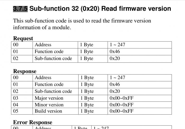

//3.7.5 Sub-function 32 (0x20) Read firmware version
SendData[0] = 0x01; //Address
SendData[1] = 0x46; //Function code
SendData[2] = 0x20; //Sub-function code
SendData[3] = 0x13; //checksum
SendData[4] = 0xB8; //checksum

В мануале написано так:
