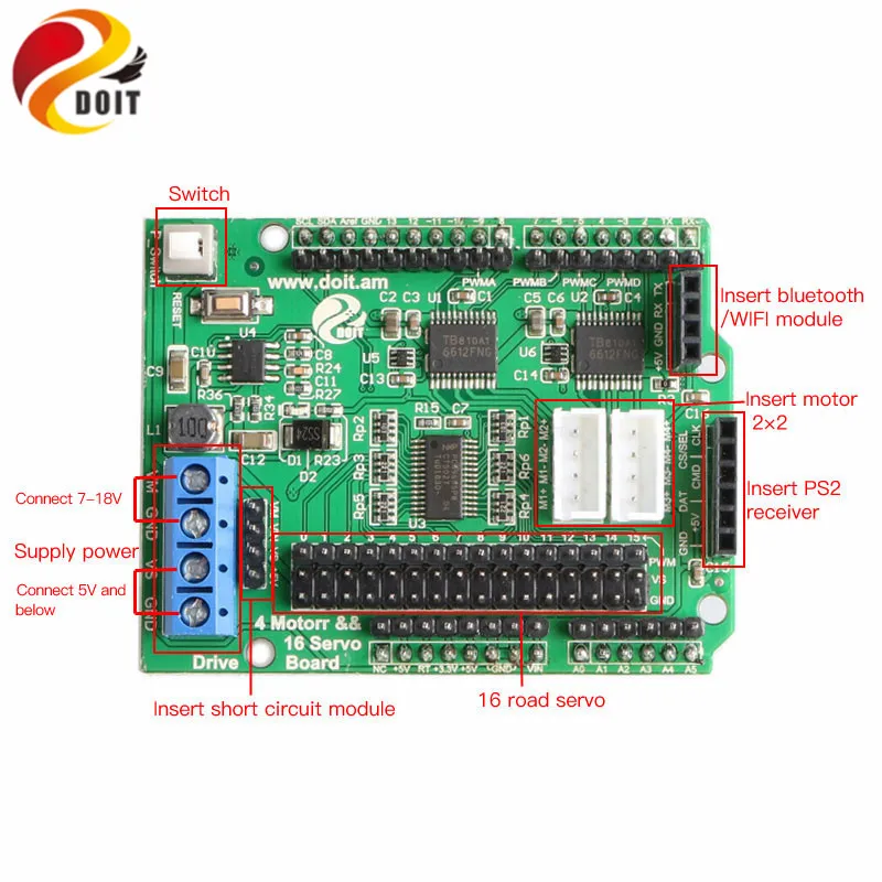

Добрый день!
 Приобрел шасси для танка
https://www.aliexpress.com/item/32827408778.html?spm=a2g0s.12269583.0.0.62976898w6ELv8
с такими моторчиками
https://www.aliexpress.com/item/32803020901.html?spm=2114.12010615.0.0.CxS3s7
Продавец посоветовал взять такую плату
https://ru.aliexpress.com/item/32916164594.html?spm=2114.12010615.8148356.27.1169273agJPmc2
Но меня терзают смутные сомненья, так как карта предназначена для 4 пиновых двигателей (подозреваю со встроенным энкодером и датчиком Холла).
Мозг сломал пока искал на али плату управления для такого тока. Так и не нашел. Прошу помощи

Спецификация на драйвер
Introduction
This motor shield can control 4ch DC motor, and 16ch servo. So it is the best choice for smart robot tank car chassis and robot arm.
Features
  • compatible with arduino;
  • simultaniously control 4ch DC motor and 16ch servo;
  • can controlled by wifi (DT-06), Bluetooth (HC-06), and PS2 station;
  • is the best choice for robot tank car chassis and robot arm;
Option Description:
  • This development board can be used with the WiFi module, Bluetooth module and handle kit for remote control of the four-wheel drive car;
  • The WiFi version and the Bluetooth version require a mobile phone to install the app, and currently only support the Android system;
  • By default, the corresponding program is programmed according to the option, and the line can be remotely controlled according to the instructions;
  • Only driver board: refers to a separate drive board, no WIFI module, Bluetooth module or handle kit;
  • According to the actual measurement, this development board can drive a load of about 3-5kg.
  • Compatible with arduino, it can be used directly by stacking.
Module pin description and schematic:
  • 16 road servo and 4 road motor drive board, using TB6612 4 road drive, PCA9685 for 16 road servo control.
  • Bring out the Arduino UNO I/O pin;
  • The maximum input voltage of the power supply is 15V/DC;
  • Reserve Bluetooth & WIFI module sockets;
  • Reserve PS2 handle socket;
  • 4 road DC motor drive, single-channel maximum drive current 1.2A average / 3.2A peak;
  • 16 road servo drive pin, power supply can be switched by external/internal power supply of jumper cap;
greyser пишет:
"Стойло ток: 4.8A"
greyser пишет:
"3.2A пик"
Вас не смущает? Меня бы смутило :(
rkit
Зарегистрирован: 23.11.2016
Эта плата на 4 мотора. Можно один мотор подключить параллельно к двум каналам, и всё будет работать.

greyser
Зарегистрирован: 27.02.2018
rkit пишет:
А как подать один и тот же сигнал на два канала?
greyser
Всем спасибо, нашел вот такой модуль под мои моторчики
https://ru.aliexpress.com/item/32680540728.html?spm=a2g0s.9042311.0.0.38bf33edWMJVKk
Monster Moto Shield VNH2SP30
Features:
Voltage max: 16V
Maximum current rating: 30 A
Practical Continuous Current: 14 A
Current sensing available analog pin
MOSFET on-resistance: 19 mΩ (per leg)
Maximum PWM frequency: 20 kHz
Thermal Shutdown
Undervoltage and Overvoltage shutdown
nik182
Зарегистрирован: 04.05.2015
Отличный модуль. Сами микросхемы на 40 вольт. Чем их китайцы до 16 ограничивают?
