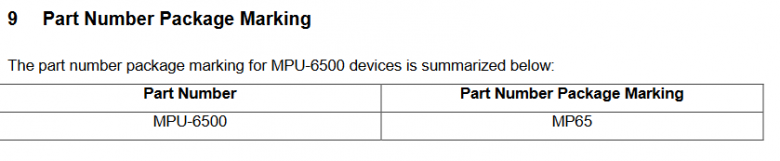

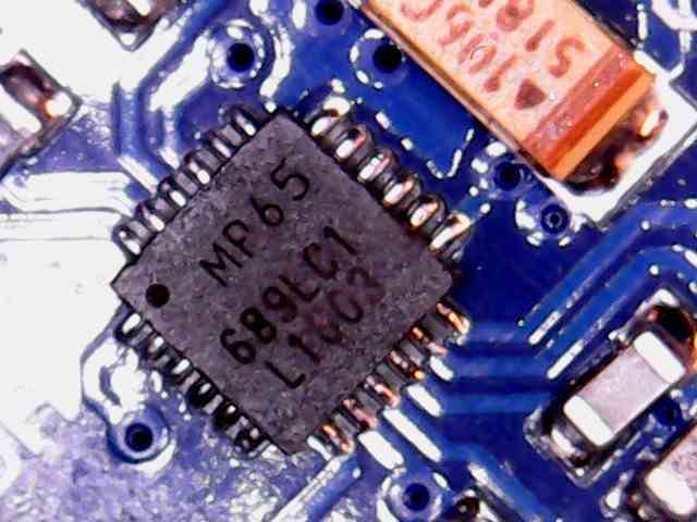

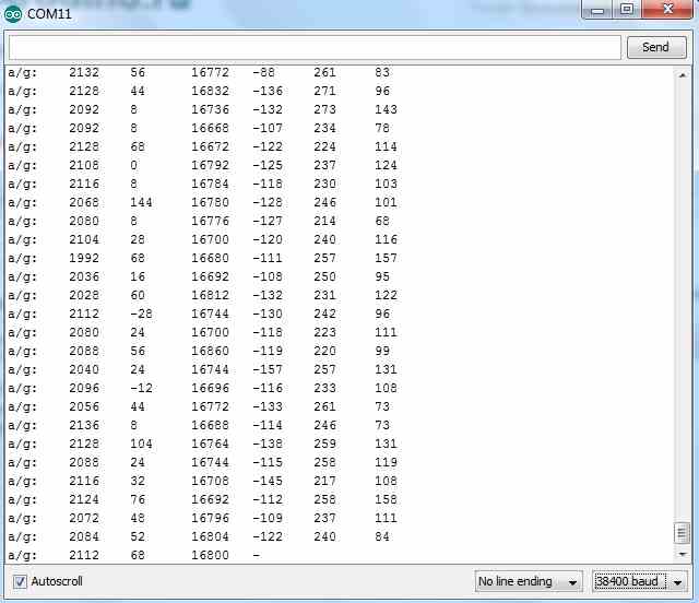

Есть данный датчик, но
скетч базовый I2C на него не откликается
https://github.com/bolderflight/MPU9250
в сериал мониторе видно только
IMU initialization unsuccessful
Check IMU wiring or try cycling power
Status: -1
/* Basic_I2C.ino Brian R Taylor brian.taylor@bolderflight.com Copyright (c) 2017 Bolder Flight Systems Permission is hereby granted, free of charge, to any person obtaining a copy of this software and associated documentation files (the "Software"), to deal in the Software without restriction, including without limitation the rights to use, copy, modify, merge, publish, distribute, sublicense, and/or sell copies of the Software, and to permit persons to whom the Software is furnished to do so, subject to the following conditions: The above copyright notice and this permission notice shall be included in all copies or substantial portions of the Software. THE SOFTWARE IS PROVIDED "AS IS", WITHOUT WARRANTY OF ANY KIND, EXPRESS OR IMPLIED, INCLUDING BUT NOT LIMITED TO THE WARRANTIES OF MERCHANTABILITY, FITNESS FOR A PARTICULAR PURPOSE AND NONINFRINGEMENT. IN NO EVENT SHALL THE AUTHORS OR COPYRIGHT HOLDERS BE LIABLE FOR ANY CLAIM, DAMAGES OR OTHER LIABILITY, WHETHER IN AN ACTION OF CONTRACT, TORT OR OTHERWISE, ARISING FROM, OUT OF OR IN CONNECTION WITH THE SOFTWARE OR THE USE OR OTHER DEALINGS IN THE SOFTWARE. */ #include "MPU9250.h" // an MPU9250 object with the MPU-9250 sensor on I2C bus 0 with address 0x68 MPU9250 IMU(Wire,0x69); int status; void setup() { // serial to display data Serial.begin(115200); while(!Serial) {} // start communication with IMU status = IMU.begin(); if (status < 0) { Serial.println("IMU initialization unsuccessful"); Serial.println("Check IMU wiring or try cycling power"); Serial.print("Status: "); Serial.println(status); while(1) {} } } void loop() { // read the sensor IMU.readSensor(); // display the data Serial.print(IMU.getAccelX_mss(),6); Serial.print("\t"); Serial.print(IMU.getAccelY_mss(),6); Serial.print("\t"); Serial.print(IMU.getAccelZ_mss(),6); Serial.print("\t"); Serial.print(IMU.getGyroX_rads(),6); Serial.print("\t"); Serial.print(IMU.getGyroY_rads(),6); Serial.print("\t"); Serial.print(IMU.getGyroZ_rads(),6); Serial.print("\t"); Serial.print(IMU.getMagX_uT(),6); Serial.print("\t"); Serial.print(IMU.getMagY_uT(),6); Serial.print("\t"); Serial.print(IMU.getMagZ_uT(),6); Serial.print("\t"); Serial.println(IMU.getTemperature_C(),6); delay(100); }
А в примере
MPU9250 Basic Example Code
by: Kris Winer
в этом примере всё вроде работает
но нужно выбирать i2c адрес 0x70, а не 0x68, как в предыдущем примере

}Так к какой версии чипа относится этот модуль,
какую библиотеку мне искать для этого модуля,
Спасибо.
в гугле забанили?
http://robot-kit.ru/manual/MPU-6500-Datasheet.pdf
судя по маркировке на микрухе
http://arduinolearning.com/code/arduino-mpu6500-6-axis-motion-tracking-device.php
