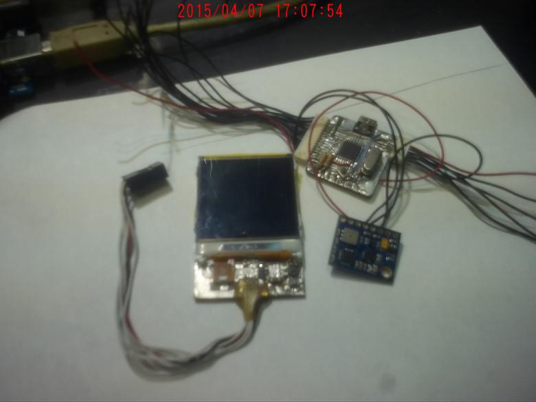

вот тоже ваял уровеь компас и тп
как jeka_tm писал
вывод на жк от 6110
#include "Wire.h" #include "I2Cdev.h" #include "HMC5883L.h" #include "MPU6050.h" #include "BMP085.h" #include <ColorLCDShield.h> LCDShield lcd; #define CLOCK_RADIUS 33 // radius of clock face #define CLOCK_CENTER 96 // If you adjust the radius, you'll probably want to adjust this #define S_LENGTH 30 // length of second hand #define BACKGROUND BLACK #define R_COLOR RED #define B_COLOR BLUE #define G_COLOR GREEN #define Y_COLOR YELLOW #define W_COLOR WHITE HMC5883L compass; BMP085 barometer; int temperature; int pressure; int heading; int32_t lastMicros; int analogPin = 1; int hum = 0; int sensorValue = 5000; int n; int acc; float altitude; int dx, dy; // class default I2C address is 0x68 MPU6050 accelgyro; int16_t ax, ay, az; int16_t gx, gy, gz; #define OUTPUT_READABLE_ACCELGYRO #define LED_PIN 13 bool blinkState = false; void setup() { analogReference(DEFAULT); Wire.begin(); compass = HMC5883L(); compass.SetScale(1.3); // Set the scale of the compass. compass.SetMeasurementMode(Measurement_Continuous); accelgyro.initialize(); barometer.initialize(); lcd.init(PHILIPS); // Initializes lcd, using an PHILIPSdriver lcd.contrast(63); // -51's usually a good contrast value lcd.clear(BACKGROUND); // clear the screen lcd.setStr("MAG", 0,0, W_COLOR, BACKGROUND); lcd.setStr("TMP", 15,0, W_COLOR, BACKGROUND); lcd.setStr("PRE", 30,0, W_COLOR, BACKGROUND); lcd.setStr("ALT", 45,0, W_COLOR, BACKGROUND); lcd.setStr("GIRO",60,0, W_COLOR,BACKGROUND); lcd.setStr("X", 75, 0, W_COLOR, BACKGROUND); lcd.setStr("Y", 90, 0, W_COLOR, BACKGROUND); lcd.setStr("Z", 105,0, W_COLOR, BACKGROUND); lcd.setStr("ACCEL", 0,70, W_COLOR, BACKGROUND); lcd.setStr("X", 15, 70, W_COLOR, BACKGROUND); lcd.setStr("Y", 30, 70, W_COLOR, BACKGROUND); lcd.setStr("HUM", 45, 70, W_COLOR, BACKGROUND); pinMode(LED_PIN, OUTPUT); } void loop() { dislayAcc(); drawClock(); char intro[10]; char temp[10]; unsigned int kk; float pressure; float temperature; // Retrived the scaled values from the compass MagnetometerRaw scaled = compass.ReadRawAxis(); // Calculate heading when the magnetometer is level, then correct for signs of axis. float heading = atan2(scaled.YAxis, scaled.XAxis); float declinationAngle = 0.0457; heading += declinationAngle; // Correct for when signs are reversed. if(heading < 0) heading += 2*PI; // Check for wrap due to addition of declination. if(heading > 2*PI) heading -= 2*PI; // Convert radians to degrees for readability. float headingDegrees = heading * 180/M_PI; // To calculate heading in degrees. 0 degree indicates North dtostrf(headingDegrees,3,0,intro); lcd.setStr(intro, 0,30, G_COLOR, BACKGROUND); displayangleDdraw(headingDegrees); //датчик влажности sensorValue = analogRead(analogPin); // считываем значение hum=(sensorValue*0.12); dtostrf(hum,3,0,temp); lcd.setStr(temp, 45,100, G_COLOR, BACKGROUND); // read raw accel/gyro measurements from device accelgyro.getMotion6(&ax, &ay, &az, &gx, &gy, &gz); // these methods (and a few others) are also available // accelgyro.getAcceleration(&ax, &ay, &az); //accelgyro.getRotation(&gx, &gy, &gz); #ifdef OUTPUT_READABLE_ACCELGYRO dtostrf(ax/500,4,0,temp); lcd.setStr(temp, 75,10, G_COLOR, BACKGROUND); dtostrf(ay/500,4,0,temp); lcd.setStr(temp, 90,10, G_COLOR, BACKGROUND); dtostrf(az/500,4,0,temp); lcd.setStr(temp,105,10, G_COLOR, BACKGROUND); dtostrf(gx/500,4,0,temp); lcd.setStr(temp, 15,80, G_COLOR, BACKGROUND); dtostrf(gy/500,4,0,temp); lcd.setStr(temp, 30,80, G_COLOR, BACKGROUND); #endif // request temperature barometer.setControl(BMP085_MODE_TEMPERATURE); // wait appropriate time for conversion (4.5ms delay) lastMicros = micros(); while (micros() - lastMicros < barometer.getMeasureDelayMicroseconds()); //delay(10); // read calibrated temperature value in degrees Celsius temperature = barometer.getTemperatureC(); dtostrf(temperature,4,1,temp); lcd.setStr(temp, 15,30, G_COLOR, BACKGROUND); // request pressure (3x oversampling mode, high detail, 23.5ms delay) barometer.setControl(BMP085_MODE_PRESSURE_3); while (micros() - lastMicros < barometer.getMeasureDelayMicroseconds()); delay (50); // read calibrated pressure value in Pascals (Pa) pressure = barometer.getPressure(); dtostrf(pressure/133.322,3,0,temp); lcd.setStr(temp, 30,30, G_COLOR, BACKGROUND); // calculate absolute altitude in meters based on known pressure // (may pass a second "sea level pressure" parameter here, // otherwise uses the standard value of 101325 Pa) altitude = barometer.getAltitude(pressure); dtostrf(-altitude/10,3,0,temp); lcd.setStr(temp, 45,30, G_COLOR, BACKGROUND); // blink LED to indicate activity blinkState = !blinkState; digitalWrite(LED_PIN, blinkState); //delay(100); } void drawClock() /* Draw the circle */ { lcd.setCircle(CLOCK_CENTER, 96, CLOCK_RADIUS, W_COLOR,3); lcd.setStr("N", CLOCK_CENTER - CLOCK_RADIUS, 100-9, Y_COLOR, BACKGROUND); lcd.setStr("E", CLOCK_CENTER - 9, 96 + CLOCK_RADIUS - 12, Y_COLOR, BACKGROUND); lcd.setStr("S", CLOCK_CENTER + CLOCK_RADIUS - 18, 95-4, Y_COLOR, BACKGROUND); lcd.setStr("W", CLOCK_CENTER - 9, 96 - CLOCK_RADIUS + 4, Y_COLOR, BACKGROUND); } void displayangleDdraw (int s) { static int sx, sy; static int nx, ny; /* Delete old lines: */ lcd.setLine(CLOCK_CENTER-1, 96-1, CLOCK_CENTER-sx-1, 96-sy-1, BACKGROUND); lcd.setLine(CLOCK_CENTER, 96, CLOCK_CENTER-sx, 96-sy, BACKGROUND); // delete second hand lcd.setLine(CLOCK_CENTER+1, 96+1, CLOCK_CENTER-sx+1, 96-sy+1, BACKGROUND); // delete second hand /* Calculate and draw new lines: */ s = map(s, 0, 360, 0, 360); // map the 0-60, to "360 degrees" sx = S_LENGTH * cos(3.14 * ((double) s)/-180 ); // woo trig! sy = S_LENGTH * sin(3.14 * ((double) s)/-180); // woo trig! lcd.setLine(CLOCK_CENTER-1 , 96-1, CLOCK_CENTER-sx-1, 96-sy-1, B_COLOR); lcd.setLine(CLOCK_CENTER , 96, CLOCK_CENTER-sx, 96-sy, B_COLOR); // print second hand lcd.setLine(CLOCK_CENTER+1 , 96+1, CLOCK_CENTER-sx+1, 96-sy+1, B_COLOR); /* Delete old lines: */ lcd.setLine(CLOCK_CENTER-1, 96-1, CLOCK_CENTER+nx-1, 96+ny-1, BACKGROUND); // delete second hand lcd.setLine(CLOCK_CENTER, 96, CLOCK_CENTER+nx, 96+ny, BACKGROUND); lcd.setLine(CLOCK_CENTER+1, 96+1, CLOCK_CENTER+nx+1, 96+ny+1, BACKGROUND); /* Calculate and draw new lines: */ n = map(s, 0, 360, 0, 360); nx = S_LENGTH * cos(3.14 * ((double) n)/-180 ); // woo trig! ny = S_LENGTH * sin(3.14 * ((double) n)/-180); // woo trig! lcd.setLine(CLOCK_CENTER-1 , 96-1, CLOCK_CENTER+nx-1, 96+ny-1, R_COLOR); // print second hand= lcd.setLine(CLOCK_CENTER , 96, CLOCK_CENTER+nx, 96+ny, R_COLOR); lcd.setLine(CLOCK_CENTER+1 , 96+1, CLOCK_CENTER+nx+1, 96+ny+1, R_COLOR); } void dislayAcc() { lcd.setCircle(CLOCK_CENTER, 96, 5, W_COLOR,1); lcd.setCircle(CLOCK_CENTER-dx, 96+dy, 3, BACKGROUND,FILL); dx=ax/500; dy=ay/500; lcd.setCircle(CLOCK_CENTER-dx, 96+dy, 3, W_COLOR,FILL); }
а фото?
к сожалению разобрал
вот фото железок используемых
на экранчике в левом нижнем углу рисовался круг со стрелкой компаса и типа шарик уровня а на остаольной площади выводились значения датчиков в цифрах
