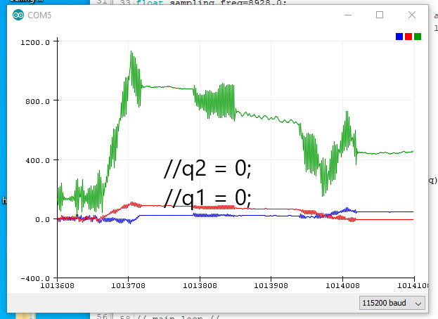

Да и q0, q1, q2 на до бы изначально инициализировать. А то хрень какая-то

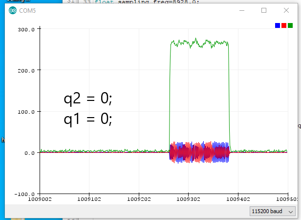

Сделал так, но есть проблема с реал и имаг.
#include <stdio.h> #include <math.h> //#include <getopt.h> //const float TARGET_FREQUENCY = 1700; int audioInPin = A0; int k, i; //int goertzel_mag(int numSamples, float TARGET_FREQUENCY, int SAMPLING_RATE, float* data); float omega, sine, cosine, coeff, q0, q1, q2, magnitude, real, imag; //int q0, q1, q2, omega, sine, cosine, coeff, magnitude, real, imag; float floatnumSamples = 20; int SAMPLING_RATE = 8900; float TARGET_FREQUENCY = 0.0; int numSamples = 20; //int numSamples = 0; int data[96]; float scalingFactor = numSamples / 2.0; //int q0 = 0; //int q1 = 0; //int q2 = 0; void setup() { TARGET_FREQUENCY = 1700; int k; k = (int) (0.5 + ((floatnumSamples * TARGET_FREQUENCY) / (float)SAMPLING_RATE)); omega = (2.0 * M_PI * k) / floatnumSamples; sine = sin(omega); cosine = cos(omega); coeff = 2.0 * cosine; Serial.begin(115200); } void loop() { for (i = 0; i < numSamples; i++) { //testData[index] = analogRead(audioInPin); data[i] = analogRead(audioInPin); //q0 = coeff * q1 - q2 + data[i]; q0 = coeff * q1 - q2 + (float) data[i]; q2 = q1; q1 = q0; } real = (q1 * cosine - q2) / scalingFactor; imag = (q1 * sine) / scalingFactor; magnitude = sqrtf(real * real + imag * imag); //phase = atan(imag/real) // q2 = 0; // q1 = 0; /* /////////////////////////////////////////// float magnitudeSquared = (q1 * q1) + (q2 * q2) - q1 * q2 * coeff; magnitude = sqrt(magnitudeSquared); //q2 = 0; //q1 = 0; //////////////////////////////////////////// */ Serial.print( real); Serial.print("\t"); Serial.print(imag); Serial.print("\t"); Serial.println(magnitude); delay(50); }
