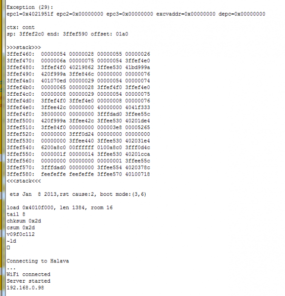

Sergeyevd
Sergeyevd аватар
Зарегистрирован: 25.03.2014
 *  This sketch demonstrates how to set up a simple HTTP-like server.
 *  The server will set a GPIO pin depending on the request
 *    http://server_ip/gpio/0 will set the GPIO2 low,
 *    http://server_ip/gpio/1 will set the GPIO2 high
 *  server_ip is the IP address of the ESP8266 module, will be
 *  printed to Serial when the module is connected.
#include "DHT.h"
#define DHTPIN 4
DHT dht(DHTPIN, DHT22);
#include <ESP8266WiFi.h>
const char* ssid = "Halava";
const char* password = "99998888";
// Create an instance of the server
// specify the port to listen on as an argument
WiFiServer server(80);
char* tem;
char* vla;
  Serial.begin(115200);
  dht.begin();
  delay(10);
  // prepare GPIO2
  pinMode(2, OUTPUT);
  digitalWrite(2, 0);
  // Connect to WiFi network
  Serial.println();
  Serial.println();
  Serial.print("Connecting to ");
  Serial.println(ssid);
  WiFi.begin(ssid, password);
    delay(500);
    Serial.print(".");
  Serial.println("");
  Serial.println("WiFi connected");
  // Start the server
  server.begin();
  Serial.println("Server started");
  // Print the IP address
  // Check if a client has connected
  WiFiClient client = server.available();
  if (!client) {
    return;
  // Wait until the client sends some data
  Serial.println("new client");
  while(!client.available()){
    delay(1);
  // Read the first line of the request
  String req = client.readStringUntil('\r');
  Serial.println(req);
  client.flush();
  // Match the request
  int val;
  if (req.indexOf("/gpio/0") != -1){
 float h=dht.readHumidity();
 float t=dht.readTemperature();
 sprintf(vla, "S0_%d", h);
 sprintf(tem, "S0_%d", t);
  else {
    Serial.println("invalid request");
    client.stop();
    return;
  // Set GPIO2 according to the request
  digitalWrite(2, val);
  client.flush();
  // Prepare the response
  String s = "HTTP/1.1 200 OK\r\nContent-Type: text/html\r\n\r\n";
s +=String(tem)+"\r\n";
s +=String(vla)+"\r\n";
  // Send the response to the client
  client.print(s);
  delay(1);
  Serial.println("Client disonnected");
  // The client will actually be disconnected
  // when the function returns and 'client' object is detroyed
http://192.168.0.98
Ответ
GET / HTTP/1.1
invalid request
Sergeyevd
Sergeyevd аватар
Почему модуль уходит в перезагрузку?
