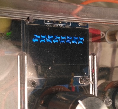

А не подскажете прочему скачанные с оф. сайта шрифты отображаются некорретно? OLED_I2C (http://www.rinkydinkelectronics.com/r_fonts.php). Сама библиотека http://www.rinkydinkelectronics.com/library.php?id=80.
#include <OLED_I2C.h> #if defined(__AVR__) #include <avr/pgmspace.h> #define fontdatatype const uint8_t #elif defined(__PIC32MX__) #define PROGMEM #define fontdatatype const unsigned char #elif defined(__arm__) #define PROGMEM #define fontdatatype const unsigned char #endif fontdatatype BigFont[3044] PROGMEM={ 0x10,0x10,0x20,0x5F, 0x00,0x00,0x00,0x00,0x00,0x00,0x00,0x00,0x00,0x00,0x00,0x00,0x00,0x00,0x00,0x00,0x00,0x00,0x00,0x00,0x00,0x00,0x00,0x00,0x00,0x00,0x00,0x00,0x00,0x00,0x00,0x00, // <space> 0x00,0x00,0x00,0x00,0x07,0x00,0x0F,0x80,0x0F,0x80,0x0F,0x80,0x0F,0x80,0x0F,0x80,0x07,0x00,0x07,0x00,0x00,0x00,0x00,0x00,0x07,0x00,0x07,0x00,0x07,0x00,0x00,0x00, // ! 0x00,0x00,0x0E,0x38,0x0E,0x38,0x0E,0x38,0x0E,0x38,0x06,0x30,0x00,0x00,0x00,0x00,0x00,0x00,0x00,0x00,0x00,0x00,0x00,0x00,0x00,0x00,0x00,0x00,0x00,0x00,0x00,0x00, // " 0x00,0x00,0x0C,0x30,0x0C,0x30,0x0C,0x30,0x7F,0xFE,0x7F,0xFE,0x0C,0x30,0x0C,0x30,0x0C,0x30,0x0C,0x30,0x7F,0xFE,0x7F,0xFE,0x0C,0x30,0x0C,0x30,0x0C,0x30,0x00,0x00, // # 0x00,0x00,0x02,0x40,0x02,0x40,0x0F,0xF8,0x1F,0xF8,0x1A,0x40,0x1A,0x40,0x1F,0xF0,0x0F,0xF8,0x02,0x58,0x02,0x58,0x1F,0xF8,0x1F,0xF0,0x02,0x40,0x02,0x40,0x00,0x00, // $ 0x00,0x00,0x00,0x00,0x00,0x00,0x0E,0x10,0x0E,0x30,0x0E,0x70,0x00,0xE0,0x01,0xC0,0x03,0x80,0x07,0x00,0x0E,0x70,0x0C,0x70,0x08,0x70,0x00,0x00,0x00,0x00,0x00,0x00, // % 0x00,0x00,0x00,0x00,0x0F,0x00,0x19,0x80,0x19,0x80,0x19,0x80,0x0F,0x00,0x0F,0x08,0x0F,0x98,0x19,0xF8,0x18,0xF0,0x18,0xE0,0x19,0xF0,0x0F,0x98,0x00,0x00,0x00,0x00, // & 0x00,0x00,0x00,0x00,0x07,0x00,0x07,0x00,0x07,0x00,0x0E,0x00,0x00,0x00,0x00,0x00,0x00,0x00,0x00,0x00,0x00,0x00,0x00,0x00,0x00,0x00,0x00,0x00,0x00,0x00,0x00,0x00, // ' 0x00,0x00,0x00,0x00,0x00,0xF0,0x01,0xC0,0x03,0x80,0x07,0x00,0x0E,0x00,0x0E,0x00,0x0E,0x00,0x0E,0x00,0x07,0x00,0x03,0x80,0x01,0xC0,0x00,0xF0,0x00,0x00,0x00,0x00, // ( 0x00,0x00,0x00,0x00,0x0F,0x00,0x03,0x80,0x01,0xC0,0x00,0xE0,0x00,0x70,0x00,0x70,0x00,0x70,0x00,0x70,0x00,0xE0,0x01,0xC0,0x03,0x80,0x0F,0x00,0x00,0x00,0x00,0x00, // ) 0x00,0x00,0x00,0x00,0x01,0x80,0x11,0x88,0x09,0x90,0x07,0xE0,0x07,0xE0,0x3F,0xFC,0x3F,0xFC,0x07,0xE0,0x07,0xE0,0x09,0x90,0x11,0x88,0x01,0x80,0x00,0x00,0x00,0x00, // * 0x00,0x00,0x00,0x00,0x00,0x00,0x00,0x00,0x01,0x80,0x01,0x80,0x01,0x80,0x0F,0xF0,0x0F,0xF0,0x01,0x80,0x01,0x80,0x01,0x80,0x00,0x00,0x00,0x00,0x00,0x00,0x00,0x00, // + 0x00,0x00,0x00,0x00,0x00,0x00,0x00,0x00,0x00,0x00,0x00,0x00,0x00,0x00,0x00,0x00,0x00,0x00,0x00,0x00,0x00,0x00,0x07,0x00,0x07,0x00,0x07,0x00,0x0E,0x00,0x00,0x00, // , 0x00,0x00,0x00,0x00,0x00,0x00,0x00,0x00,0x00,0x00,0x00,0x00,0x00,0x00,0x1F,0xF8,0x1F,0xF8,0x00,0x00,0x00,0x00,0x00,0x00,0x00,0x00,0x00,0x00,0x00,0x00,0x00,0x00, // - 0x00,0x00,0x00,0x00,0x00,0x00,0x00,0x00,0x00,0x00,0x00,0x00,0x00,0x00,0x00,0x00,0x00,0x00,0x00,0x00,0x00,0x00,0x07,0x00,0x07,0x00,0x07,0x00,0x00,0x00,0x00,0x00, // . 0x00,0x00,0x00,0x00,0x00,0x02,0x00,0x06,0x00,0x0E,0x00,0x1C,0x00,0x38,0x00,0x70,0x00,0xE0,0x01,0xC0,0x03,0x80,0x07,0x00,0x0E,0x00,0x1C,0x00,0x00,0x00,0x00,0x00, // / 0x00,0x00,0x00,0x00,0x0F,0xF0,0x1C,0x38,0x1C,0x78,0x1C,0xF8,0x1C,0xF8,0x1D,0xB8,0x1D,0xB8,0x1F,0x38,0x1F,0x38,0x1E,0x38,0x1C,0x38,0x0F,0xF0,0x00,0x00,0x00,0x00, // 0 0x00,0x00,0x00,0x00,0x01,0x80,0x01,0x80,0x03,0x80,0x1F,0x80,0x1F,0x80,0x03,0x80,0x03,0x80,0x03,0x80,0x03,0x80,0x03,0x80,0x03,0x80,0x1F,0xF0,0x00,0x00,0x00,0x00, // 1 0x00,0x00,0x00,0x00,0x0F,0xE0,0x1C,0x70,0x1C,0x38,0x00,0x38,0x00,0x70,0x00,0xE0,0x01,0xC0,0x03,0x80,0x07,0x00,0x0E,0x38,0x1C,0x38,0x1F,0xF8,0x00,0x00,0x00,0x00, // 2 0x00,0x00,0x00,0x00,0x0F,0xE0,0x1C,0x70,0x1C,0x38,0x00,0x38,0x00,0x70,0x03,0xC0,0x03,0xC0,0x00,0x70,0x00,0x38,0x1C,0x38,0x1C,0x70,0x0F,0xE0,0x00,0x00,0x00,0x00, // 3 0x00,0x00,0x00,0x00,0x00,0xE0,0x01,0xE0,0x03,0xE0,0x06,0xE0,0x0C,0xE0,0x18,0xE0,0x1F,0xF8,0x1F,0xF8,0x00,0xE0,0x00,0xE0,0x00,0xE0,0x03,0xF8,0x00,0x00,0x00,0x00, // 4 0x00,0x00,0x00,0x00,0x1F,0xF8,0x1C,0x00,0x1C,0x00,0x1C,0x00,0x1C,0x00,0x1F,0xE0,0x1F,0xF0,0x00,0x78,0x00,0x38,0x1C,0x38,0x1C,0x70,0x0F,0xE0,0x00,0x00,0x00,0x00, // 5 0x00,0x00,0x00,0x00,0x03,0xE0,0x07,0x00,0x0E,0x00,0x1C,0x00,0x1C,0x00,0x1F,0xF0,0x1F,0xF8,0x1C,0x38,0x1C,0x38,0x1C,0x38,0x1C,0x38,0x0F,0xF0,0x00,0x00,0x00,0x00, // 6 0x00,0x00,0x00,0x00,0x1F,0xFC,0x1C,0x1C,0x1C,0x1C,0x1C,0x1C,0x00,0x1C,0x00,0x38,0x00,0x70,0x00,0xE0,0x01,0xC0,0x03,0x80,0x03,0x80,0x03,0x80,0x00,0x00,0x00,0x00, // 7 0x00,0x00,0x00,0x00,0x0F,0xF0,0x1C,0x38,0x1C,0x38,0x1C,0x38,0x1F,0x38,0x07,0xE0,0x07,0xE0,0x1C,0xF8,0x1C,0x38,0x1C,0x38,0x1C,0x38,0x0F,0xF0,0x00,0x00,0x00,0x00, // 8 0x00,0x00,0x00,0x00,0x0F,0xF0,0x1C,0x38,0x1C,0x38,0x1C,0x38,0x1C,0x38,0x1F,0xF8,0x0F,0xF8,0x00,0x38,0x00,0x38,0x00,0x70,0x00,0xE0,0x07,0xC0,0x00,0x00,0x00,0x00, // 9 0x00,0x00,0x00,0x00,0x00,0x00,0x00,0x00,0x03,0x80,0x03,0x80,0x03,0x80,0x00,0x00,0x00,0x00,0x03,0x80,0x03,0x80,0x03,0x80,0x00,0x00,0x00,0x00,0x00,0x00,0x00,0x00, // : 0x00,0x00,0x00,0x00,0x00,0x00,0x00,0x00,0x03,0x80,0x03,0x80,0x03,0x80,0x00,0x00,0x00,0x00,0x03,0x80,0x03,0x80,0x03,0x80,0x07,0x00,0x00,0x00,0x00,0x00,0x00,0x00, // ; 0x00,0x00,0x00,0x70,0x00,0xE0,0x01,0xC0,0x03,0x80,0x07,0x00,0x0E,0x00,0x1C,0x00,0x1C,0x00,0x0E,0x00,0x07,0x00,0x03,0x80,0x01,0xC0,0x00,0xE0,0x00,0x70,0x00,0x00, // < 0x00,0x00,0x00,0x00,0x00,0x00,0x00,0x00,0x00,0x00,0x3F,0xFC,0x3F,0xFC,0x00,0x00,0x00,0x00,0x3F,0xFC,0x3F,0xFC,0x00,0x00,0x00,0x00,0x00,0x00,0x00,0x00,0x00,0x00, // = 0x00,0x00,0x1C,0x00,0x0E,0x00,0x07,0x00,0x03,0x80,0x01,0xC0,0x00,0xE0,0x00,0x70,0x00,0x70,0x00,0xE0,0x01,0xC0,0x03,0x80,0x07,0x00,0x0E,0x00,0x1C,0x00,0x00,0x00, // > 0x00,0x00,0x03,0xC0,0x0F,0xF0,0x1E,0x78,0x18,0x38,0x00,0x38,0x00,0x70,0x00,0xE0,0x01,0xC0,0x01,0xC0,0x00,0x00,0x00,0x00,0x01,0xC0,0x01,0xC0,0x01,0xC0,0x00,0x00, // ? 0x00,0x00,0x0F,0xF8,0x1C,0x1C,0x1C,0x1C,0x1C,0x1C,0x1C,0x1C,0x1C,0xFC,0x1C,0xFC,0x1C,0xFC,0x1C,0xFC,0x1C,0x00,0x1C,0x00,0x1C,0x00,0x1F,0xF0,0x07,0xF8,0x00,0x00, // @ 0x00,0x00,0x00,0x00,0x03,0xC0,0x07,0xE0,0x0E,0x70,0x1C,0x38,0x1C,0x38,0x1C,0x38,0x1C,0x38,0x1F,0xF8,0x1C,0x38,0x1C,0x38,0x1C,0x38,0x1C,0x38,0x00,0x00,0x00,0x00, // A 0x00,0x00,0x00,0x00,0x1F,0xF0,0x0E,0x38,0x0E,0x38,0x0E,0x38,0x0E,0x38,0x0F,0xF0,0x0F,0xF0,0x0E,0x38,0x0E,0x38,0x0E,0x38,0x0E,0x38,0x1F,0xF0,0x00,0x00,0x00,0x00, // B 0x00,0x00,0x00,0x00,0x07,0xF0,0x0E,0x38,0x1C,0x38,0x1C,0x00,0x1C,0x00,0x1C,0x00,0x1C,0x00,0x1C,0x00,0x1C,0x00,0x1C,0x38,0x0E,0x38,0x07,0xF0,0x00,0x00,0x00,0x00, // C 0x00,0x00,0x00,0x00,0x1F,0xE0,0x0E,0x70,0x0E,0x38,0x0E,0x38,0x0E,0x38,0x0E,0x38,0x0E,0x38,0x0E,0x38,0x0E,0x38,0x0E,0x38,0x0E,0x70,0x1F,0xE0,0x00,0x00,0x00,0x00, // D 0x00,0x00,0x00,0x00,0x1F,0xF8,0x0E,0x18,0x0E,0x08,0x0E,0x00,0x0E,0x30,0x0F,0xF0,0x0F,0xF0,0x0E,0x30,0x0E,0x00,0x0E,0x08,0x0E,0x18,0x1F,0xF8,0x00,0x00,0x00,0x00, // E 0x00,0x00,0x00,0x00,0x1F,0xF8,0x0E,0x18,0x0E,0x08,0x0E,0x00,0x0E,0x30,0x0F,0xF0,0x0F,0xF0,0x0E,0x30,0x0E,0x00,0x0E,0x00,0x0E,0x00,0x1F,0x00,0x00,0x00,0x00,0x00, // F 0x00,0x00,0x00,0x00,0x07,0xF0,0x0E,0x38,0x1C,0x38,0x1C,0x38,0x1C,0x00,0x1C,0x00,0x1C,0x00,0x1C,0xF8,0x1C,0x38,0x1C,0x38,0x0E,0x38,0x07,0xF8,0x00,0x00,0x00,0x00, // G 0x00,0x00,0x00,0x00,0x1C,0x70,0x1C,0x70,0x1C,0x70,0x1C,0x70,0x1C,0x70,0x1F,0xF0,0x1F,0xF0,0x1C,0x70,0x1C,0x70,0x1C,0x70,0x1C,0x70,0x1C,0x70,0x00,0x00,0x00,0x00, // H 0x00,0x00,0x00,0x00,0x0F,0xE0,0x03,0x80,0x03,0x80,0x03,0x80,0x03,0x80,0x03,0x80,0x03,0x80,0x03,0x80,0x03,0x80,0x03,0x80,0x03,0x80,0x0F,0xE0,0x00,0x00,0x00,0x00, // I 0x00,0x00,0x00,0x00,0x01,0xFC,0x00,0x70,0x00,0x70,0x00,0x70,0x00,0x70,0x00,0x70,0x00,0x70,0x38,0x70,0x38,0x70,0x38,0x70,0x38,0x70,0x0F,0xE0,0x00,0x00,0x00,0x00, // J 0x00,0x00,0x00,0x00,0x1E,0x38,0x0E,0x38,0x0E,0x70,0x0E,0xE0,0x0F,0xC0,0x0F,0x80,0x0F,0x80,0x0F,0xC0,0x0E,0xE0,0x0E,0x70,0x0E,0x38,0x1E,0x38,0x00,0x00,0x00,0x00, // K 0x00,0x00,0x00,0x00,0x1F,0x00,0x0E,0x00,0x0E,0x00,0x0E,0x00,0x0E,0x00,0x0E,0x00,0x0E,0x00,0x0E,0x00,0x0E,0x08,0x0E,0x18,0x0E,0x38,0x1F,0xF8,0x00,0x00,0x00,0x00, // L 0x00,0x00,0x00,0x00,0x1C,0x1C,0x1E,0x3C,0x1F,0x7C,0x1F,0xFC,0x1F,0xFC,0x1D,0xDC,0x1C,0x9C,0x1C,0x1C,0x1C,0x1C,0x1C,0x1C,0x1C,0x1C,0x1C,0x1C,0x00,0x00,0x00,0x00, // M 0x00,0x00,0x00,0x00,0x1C,0x1C,0x1C,0x1C,0x1E,0x1C,0x1F,0x1C,0x1F,0x9C,0x1D,0xDC,0x1C,0xFC,0x1C,0x7C,0x1C,0x3C,0x1C,0x1C,0x1C,0x1C,0x1C,0x1C,0x00,0x00,0x00,0x00, // N 0x00,0x00,0x00,0x00,0x03,0xE0,0x07,0xF0,0x0E,0x38,0x1C,0x1C,0x1C,0x1C,0x1C,0x1C,0x1C,0x1C,0x1C,0x1C,0x1C,0x1C,0x0E,0x38,0x07,0xF0,0x03,0xE0,0x00,0x00,0x00,0x00, // O 0x00,0x00,0x00,0x00,0x1F,0xF0,0x0E,0x38,0x0E,0x38,0x0E,0x38,0x0E,0x38,0x0F,0xF0,0x0F,0xF0,0x0E,0x00,0x0E,0x00,0x0E,0x00,0x0E,0x00,0x1F,0x00,0x00,0x00,0x00,0x00, // P 0x00,0x00,0x00,0x00,0x03,0xE0,0x0F,0x78,0x0E,0x38,0x1C,0x1C,0x1C,0x1C,0x1C,0x1C,0x1C,0x1C,0x1C,0x7C,0x1C,0xFC,0x0F,0xF8,0x0F,0xF8,0x00,0x38,0x00,0xFC,0x00,0x00, // Q 0x00,0x00,0x00,0x00,0x1F,0xF0,0x0E,0x38,0x0E,0x38,0x0E,0x38,0x0E,0x38,0x0F,0xF0,0x0F,0xF0,0x0E,0x70,0x0E,0x38,0x0E,0x38,0x0E,0x38,0x1E,0x38,0x00,0x00,0x00,0x00, // R 0x00,0x00,0x00,0x00,0x0F,0xF0,0x1C,0x38,0x1C,0x38,0x1C,0x38,0x1C,0x00,0x0F,0xE0,0x07,0xF0,0x00,0x38,0x1C,0x38,0x1C,0x38,0x1C,0x38,0x0F,0xF0,0x00,0x00,0x00,0x00, // S 0x00,0x00,0x00,0x00,0x1F,0xFC,0x19,0xCC,0x11,0xC4,0x01,0xC0,0x01,0xC0,0x01,0xC0,0x01,0xC0,0x01,0xC0,0x01,0xC0,0x01,0xC0,0x01,0xC0,0x07,0xF0,0x00,0x00,0x00,0x00, // T 0x00,0x00,0x00,0x00,0x1C,0x70,0x1C,0x70,0x1C,0x70,0x1C,0x70,0x1C,0x70,0x1C,0x70,0x1C,0x70,0x1C,0x70,0x1C,0x70,0x1C,0x70,0x1C,0x70,0x0F,0xE0,0x00,0x00,0x00,0x00, // U 0x00,0x00,0x00,0x00,0x1C,0x70,0x1C,0x70,0x1C,0x70,0x1C,0x70,0x1C,0x70,0x1C,0x70,0x1C,0x70,0x1C,0x70,0x1C,0x70,0x0E,0xE0,0x07,0xC0,0x03,0x80,0x00,0x00,0x00,0x00, // V 0x00,0x00,0x00,0x00,0x1C,0x1C,0x1C,0x1C,0x1C,0x1C,0x1C,0x1C,0x1C,0x1C,0x1C,0x9C,0x1C,0x9C,0x1C,0x9C,0x0F,0xF8,0x0F,0xF8,0x07,0x70,0x07,0x70,0x00,0x00,0x00,0x00, // W 0x00,0x00,0x00,0x00,0x1C,0x70,0x1C,0x70,0x1C,0x70,0x0E,0xE0,0x07,0xC0,0x03,0x80,0x03,0x80,0x07,0xC0,0x0E,0xE0,0x1C,0x70,0x1C,0x70,0x1C,0x70,0x00,0x00,0x00,0x00, // X 0x00,0x00,0x00,0x00,0x1C,0x70,0x1C,0x70,0x1C,0x70,0x1C,0x70,0x1C,0x70,0x0E,0xE0,0x07,0xC0,0x03,0x80,0x03,0x80,0x03,0x80,0x03,0x80,0x0F,0xE0,0x00,0x00,0x00,0x00, // Y 0x00,0x00,0x00,0x00,0x1F,0xF8,0x1C,0x38,0x18,0x38,0x10,0x70,0x00,0xE0,0x01,0xC0,0x03,0x80,0x07,0x00,0x0E,0x08,0x1C,0x18,0x1C,0x38,0x1F,0xF8,0x00,0x00,0x00,0x00, // Z 0x00,0x00,0x00,0x00,0x07,0xF0,0x07,0x00,0x07,0x00,0x07,0x00,0x07,0x00,0x07,0x00,0x07,0x00,0x07,0x00,0x07,0x00,0x07,0x00,0x07,0x00,0x07,0xF0,0x00,0x00,0x00,0x00, // [ 0x00,0x00,0x00,0x00,0x10,0x00,0x18,0x00,0x1C,0x00,0x0E,0x00,0x07,0x00,0x03,0x80,0x01,0xC0,0x00,0xE0,0x00,0x70,0x00,0x38,0x00,0x1C,0x00,0x07,0x00,0x00,0x00,0x00, // <backslash> 0x00,0x00,0x00,0x00,0x07,0xF0,0x00,0x70,0x00,0x70,0x00,0x70,0x00,0x70,0x00,0x70,0x00,0x70,0x00,0x70,0x00,0x70,0x00,0x70,0x00,0x70,0x07,0xF0,0x00,0x00,0x00,0x00, // ] 0x00,0x00,0x01,0x80,0x03,0xC0,0x07,0xE0,0x0E,0x70,0x1C,0x38,0x00,0x00,0x00,0x00,0x00,0x00,0x00,0x00,0x00,0x00,0x00,0x00,0x00,0x00,0x00,0x00,0x00,0x00,0x00,0x00, // ^ 0x00,0x00,0x00,0x00,0x00,0x00,0x00,0x00,0x00,0x00,0x00,0x00,0x00,0x00,0x00,0x00,0x00,0x00,0x00,0x00,0x00,0x00,0x00,0x00,0x00,0x00,0x00,0x00,0x7F,0xFF,0x7F,0xFF, // _ 0x00,0x00,0x00,0x00,0x1C,0x00,0x1C,0x00,0x07,0x00,0x07,0x00,0x00,0x00,0x00,0x00,0x00,0x00,0x00,0x00,0x00,0x00,0x00,0x00,0x00,0x00,0x00,0x00,0x00,0x00,0x00,0x00, // ` 0x00,0x00,0x00,0x00,0x00,0x00,0x00,0x00,0x00,0x00,0x00,0x00,0x0F,0xE0,0x00,0x70,0x00,0x70,0x0F,0xF0,0x1C,0x70,0x1C,0x70,0x1C,0x70,0x0F,0xD8,0x00,0x00,0x00,0x00, // a 0x00,0x00,0x00,0x00,0x1E,0x00,0x0E,0x00,0x0E,0x00,0x0E,0x00,0x0F,0xF0,0x0E,0x38,0x0E,0x38,0x0E,0x38,0x0E,0x38,0x0E,0x38,0x0E,0x38,0x1B,0xF0,0x00,0x00,0x00,0x00, // b 0x00,0x00,0x00,0x00,0x00,0x00,0x00,0x00,0x00,0x00,0x00,0x00,0x0F,0xE0,0x1C,0x70,0x1C,0x70,0x1C,0x00,0x1C,0x00,0x1C,0x70,0x1C,0x70,0x0F,0xE0,0x00,0x00,0x00,0x00, // c 0x00,0x00,0x00,0x00,0x00,0xF8,0x00,0x70,0x00,0x70,0x00,0x70,0x0F,0xF0,0x1C,0x70,0x1C,0x70,0x1C,0x70,0x1C,0x70,0x1C,0x70,0x1C,0x70,0x0F,0xD8,0x00,0x00,0x00,0x00, // d 0x00,0x00,0x00,0x00,0x00,0x00,0x00,0x00,0x00,0x00,0x00,0x00,0x0F,0xE0,0x1C,0x70,0x1C,0x70,0x1F,0xF0,0x1C,0x00,0x1C,0x70,0x1C,0x70,0x0F,0xE0,0x00,0x00,0x00,0x00, // e 0x00,0x00,0x00,0x00,0x03,0xE0,0x07,0x70,0x07,0x70,0x07,0x00,0x07,0x00,0x1F,0xE0,0x1F,0xE0,0x07,0x00,0x07,0x00,0x07,0x00,0x07,0x00,0x1F,0xC0,0x00,0x00,0x00,0x00, // f 0x00,0x00,0x00,0x00,0x00,0x00,0x00,0x00,0x00,0x00,0x00,0x00,0x0F,0xD8,0x1C,0x70,0x1C,0x70,0x1C,0x70,0x1C,0x70,0x0F,0xF0,0x07,0xF0,0x00,0x70,0x1C,0x70,0x0F,0xE0, // g 0x00,0x00,0x00,0x00,0x1E,0x00,0x0E,0x00,0x0E,0x00,0x0E,0x00,0x0E,0xF0,0x0F,0x38,0x0F,0x38,0x0E,0x38,0x0E,0x38,0x0E,0x38,0x0E,0x38,0x1E,0x38,0x00,0x00,0x00,0x00, // h 0x00,0x00,0x00,0x00,0x01,0xC0,0x01,0xC0,0x01,0xC0,0x00,0x00,0x0F,0xC0,0x01,0xC0,0x01,0xC0,0x01,0xC0,0x01,0xC0,0x01,0xC0,0x01,0xC0,0x0F,0xF8,0x00,0x00,0x00,0x00, // i 0x00,0x00,0x00,0x00,0x00,0x70,0x00,0x70,0x00,0x70,0x00,0x00,0x03,0xF0,0x00,0x70,0x00,0x70,0x00,0x70,0x00,0x70,0x00,0x70,0x00,0x70,0x1C,0x70,0x0C,0xF0,0x07,0xE0, // j 0x00,0x00,0x00,0x00,0x1E,0x00,0x0E,0x00,0x0E,0x00,0x0E,0x00,0x0E,0x38,0x0E,0x70,0x0E,0xE0,0x0F,0xC0,0x0E,0xE0,0x0E,0x70,0x0E,0x38,0x1E,0x38,0x00,0x00,0x00,0x00, // k 0x00,0x00,0x00,0x00,0x0F,0xC0,0x01,0xC0,0x01,0xC0,0x01,0xC0,0x01,0xC0,0x01,0xC0,0x01,0xC0,0x01,0xC0,0x01,0xC0,0x01,0xC0,0x01,0xC0,0x0F,0xF8,0x00,0x00,0x00,0x00, // l 0x00,0x00,0x00,0x00,0x00,0x00,0x00,0x00,0x00,0x00,0x00,0x00,0x1F,0xF8,0x1C,0x9C,0x1C,0x9C,0x1C,0x9C,0x1C,0x9C,0x1C,0x9C,0x1C,0x9C,0x1C,0x9C,0x00,0x00,0x00,0x00, // m 0x00,0x00,0x00,0x00,0x00,0x00,0x00,0x00,0x00,0x00,0x00,0x00,0x1F,0xE0,0x1C,0x70,0x1C,0x70,0x1C,0x70,0x1C,0x70,0x1C,0x70,0x1C,0x70,0x1C,0x70,0x00,0x00,0x00,0x00, // n 0x00,0x00,0x00,0x00,0x00,0x00,0x00,0x00,0x00,0x00,0x00,0x00,0x0F,0xE0,0x1C,0x70,0x1C,0x70,0x1C,0x70,0x1C,0x70,0x1C,0x70,0x1C,0x70,0x0F,0xE0,0x00,0x00,0x00,0x00, // o 0x00,0x00,0x00,0x00,0x00,0x00,0x00,0x00,0x00,0x00,0x00,0x00,0x1B,0xF0,0x0E,0x38,0x0E,0x38,0x0E,0x38,0x0E,0x38,0x0E,0x38,0x0F,0xF0,0x0E,0x00,0x0E,0x00,0x1F,0x00, // p 0x00,0x00,0x00,0x00,0x00,0x00,0x00,0x00,0x00,0x00,0x00,0x00,0x1F,0xB0,0x38,0xE0,0x38,0xE0,0x38,0xE0,0x38,0xE0,0x38,0xE0,0x1F,0xE0,0x00,0xE0,0x00,0xE0,0x01,0xF0, // q 0x00,0x00,0x00,0x00,0x00,0x00,0x00,0x00,0x00,0x00,0x00,0x00,0x1E,0xF0,0x0F,0xF8,0x0F,0x38,0x0E,0x00,0x0E,0x00,0x0E,0x00,0x0E,0x00,0x1F,0x00,0x00,0x00,0x00,0x00, // r 0x00,0x00,0x00,0x00,0x00,0x00,0x00,0x00,0x00,0x00,0x00,0x00,0x0F,0xE0,0x1C,0x30,0x1C,0x30,0x0F,0x80,0x03,0xE0,0x18,0x70,0x18,0x70,0x0F,0xE0,0x00,0x00,0x00,0x00, // s 0x00,0x00,0x00,0x00,0x00,0x00,0x01,0x00,0x03,0x00,0x07,0x00,0x1F,0xF0,0x07,0x00,0x07,0x00,0x07,0x00,0x07,0x00,0x07,0x70,0x07,0x70,0x03,0xE0,0x00,0x00,0x00,0x00, // t 0x00,0x00,0x00,0x00,0x00,0x00,0x00,0x00,0x00,0x00,0x00,0x00,0x1C,0x70,0x1C,0x70,0x1C,0x70,0x1C,0x70,0x1C,0x70,0x1C,0x70,0x1C,0x70,0x0F,0xD8,0x00,0x00,0x00,0x00, // u 0x00,0x00,0x00,0x00,0x00,0x00,0x00,0x00,0x00,0x00,0x00,0x00,0x1C,0x70,0x1C,0x70,0x1C,0x70,0x1C,0x70,0x1C,0x70,0x0E,0xE0,0x07,0xC0,0x03,0x80,0x00,0x00,0x00,0x00, // v 0x00,0x00,0x00,0x00,0x00,0x00,0x00,0x00,0x00,0x00,0x00,0x00,0x1C,0x1C,0x1C,0x1C,0x1C,0x1C,0x1C,0x9C,0x1C,0x9C,0x0F,0xF8,0x07,0x70,0x07,0x70,0x00,0x00,0x00,0x00, // w 0x00,0x00,0x00,0x00,0x00,0x00,0x00,0x00,0x00,0x00,0x00,0x00,0x1C,0xE0,0x1C,0xE0,0x0F,0xC0,0x07,0x80,0x07,0x80,0x0F,0xC0,0x1C,0xE0,0x1C,0xE0,0x00,0x00,0x00,0x00, // x 0x00,0x00,0x00,0x00,0x00,0x00,0x00,0x00,0x00,0x00,0x00,0x00,0x0E,0x38,0x0E,0x38,0x0E,0x38,0x0E,0x38,0x0E,0x38,0x07,0xF0,0x03,0xE0,0x00,0xE0,0x01,0xC0,0x1F,0x80, // y 0x00,0x00,0x00,0x00,0x00,0x00,0x00,0x00,0x00,0x00,0x00,0x00,0x1F,0xE0,0x18,0xE0,0x11,0xC0,0x03,0x80,0x07,0x00,0x0E,0x20,0x1C,0x60,0x1F,0xE0,0x00,0x00,0x00,0x00, // z 0x00,0x00,0x00,0x00,0x01,0xF8,0x03,0x80,0x03,0x80,0x03,0x80,0x07,0x00,0x1C,0x00,0x1C,0x00,0x07,0x00,0x03,0x80,0x03,0x80,0x03,0x80,0x01,0xF8,0x00,0x00,0x00,0x00, // { 0x00,0x00,0x01,0xC0,0x01,0xC0,0x01,0xC0,0x01,0xC0,0x01,0xC0,0x01,0xC0,0x01,0xC0,0x01,0xC0,0x01,0xC0,0x01,0xC0,0x01,0xC0,0x01,0xC0,0x01,0xC0,0x01,0xC0,0x00,0x00, // | 0x00,0x00,0x00,0x00,0x1F,0x80,0x01,0xC0,0x01,0xC0,0x01,0xC0,0x00,0xE0,0x00,0x38,0x00,0x38,0x00,0xE0,0x01,0xC0,0x01,0xC0,0x01,0xC0,0x1F,0x80,0x00,0x00,0x00,0x00, // } 0x00,0x00,0x00,0x00,0x1F,0x1C,0x3B,0x9C,0x39,0xDC,0x38,0xF8,0x00,0x00,0x00,0x00,0x00,0x00,0x00,0x00,0x00,0x00,0x00,0x00,0x00,0x00,0x00,0x00,0x00,0x00,0x00,0x00, // ~ }; OLED myOLED(SDA, SCL); void setup() { myOLED.begin(); myOLED.setFont(BigFont); myOLED.clrScr(); myOLED.print("ASDASDDSFER1231", 0, 10); myOLED.update(); } void loop() { }Whitefoot-gl, по поводу библиотек сказать не могу т.к. пользуюсь исключительно собственной, но I2C - довольно менделнная шина, а дисплей графический, и запихать на него нужно 1к данных.
