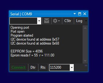

в классе
	template<typename T>
	T operator[](const int idx) {
		if (sizeof(T) == 4) return 111.00;
		else return 55;
в сетапе
	Serial.begin(115200);
	Serial << F("Program started\n");
	findI2CDevice();
	Serial << "\nEEPROM Size = " << ExtEprom.Size << eoln;
	int f = ExtEprom.operator[]<int>(0);
	float r = ExtEprom.operator[]<float>(2);
	Serial << "Eprom reads f = " << f << "  r = " << r << eoln;
в порту
