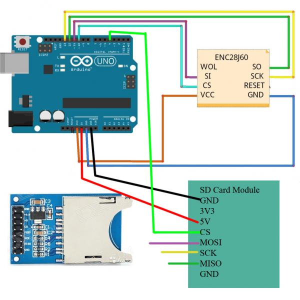

Я решил пойти немного по другому пути, авось получится...
Подключил модуль SD карты.
Загрузил на карту файл index.htm
В ардуинку загрузил код из выше указанной статьи.
#include <SPI.h> #include <Ethernet.h> #include <SD.h> // size of buffer used to capture HTTP requests #define REQ_BUF_SZ 50 // MAC address from Ethernet shield sticker under board byte mac[] = { 0xDE, 0xAD, 0xBE, 0xEF, 0xFE, 0xED }; IPAddress ip(192, 168, 1, 177); // IP address, may need to change depending on network EthernetServer server(80); // create a server at port 80 File webFile; // the web page file on the SD card char HTTP_req[REQ_BUF_SZ] = {0}; // buffered HTTP request stored as null terminated string char req_index = 0; // index into HTTP_req buffer void setup() { // disable Ethernet chip pinMode(10, OUTPUT); digitalWrite(10, HIGH); Serial.begin(9600); // for debugging // initialize SD card Serial.println("Initializing SD card..."); if (!SD.begin(4)) { Serial.println("ERROR - SD card initialization failed!"); return; // init failed } Serial.println("SUCCESS - SD card initialized."); // check for index.htm file if (!SD.exists("index.htm")) { Serial.println("ERROR - Can't find index.htm file!"); return; // can't find index file } Serial.println("SUCCESS - Found index.htm file."); Ethernet.begin(mac, ip); // initialize Ethernet device server.begin(); // start to listen for clients } void loop() { EthernetClient client = server.available(); // try to get client if (client) { // got client? boolean currentLineIsBlank = true; while (client.connected()) { if (client.available()) { // client data available to read char c = client.read(); // read 1 byte (character) from client // buffer first part of HTTP request in HTTP_req array (string) // leave last element in array as 0 to null terminate string (REQ_BUF_SZ - 1) if (req_index < (REQ_BUF_SZ - 1)) { HTTP_req[req_index] = c; // save HTTP request character req_index++; } // last line of client request is blank and ends with \n // respond to client only after last line received if (c == '\n' && currentLineIsBlank) { // send a standard http response header client.println("HTTP/1.1 200 OK"); // remainder of header follows below, depending on if // web page or XML page is requested // Ajax request - send XML file if (StrContains(HTTP_req, "ajax_inputs")) { // send rest of HTTP header client.println("Content-Type: text/xml"); client.println("Connection: keep-alive"); client.println(); // send XML file containing input states XML_response(client); } else { // web page request // send rest of HTTP header client.println("Content-Type: text/html"); client.println("Connection: keep-alive"); client.println(); // send web page webFile = SD.open("index.htm"); // open web page file if (webFile) { while(webFile.available()) { client.write(webFile.read()); // send web page to client } webFile.close(); } } // display received HTTP request on serial port Serial.print(HTTP_req); // reset buffer index and all buffer elements to 0 req_index = 0; StrClear(HTTP_req, REQ_BUF_SZ); break; } // every line of text received from the client ends with \r\n if (c == '\n') { // last character on line of received text // starting new line with next character read currentLineIsBlank = true; } else if (c != '\r') { // a text character was received from client currentLineIsBlank = false; } } // end if (client.available()) } // end while (client.connected()) delay(1); // give the web browser time to receive the data client.stop(); // close the connection } // end if (client) } // send the XML file containing analog value void XML_response(EthernetClient cl) { int analog_val_1 = 0; int analog_val_2 = 0; char sample; // get the sum of 10 samples from analog inputs 2 and 3 for (sample = 0; sample < 10; sample++) { analog_val_1 += analogRead(2); delay(2); analog_val_2 += analogRead(3); delay(2); } // calculate the average of the 10 samples analog_val_1 /= 10; analog_val_2 /= 10; cl.print("<?xml version = \"1.0\" ?>"); cl.print("<inputs>"); // read analog pin A2 // analog_val = analogRead(2); cl.print("<analog>"); cl.print(analog_val_1); cl.print("</analog>"); // analog_val = analogRead(3); cl.print("<analog>"); cl.print(analog_val_2); cl.print("</analog>"); cl.print("</inputs>"); } // sets every element of str to 0 (clears array) void StrClear(char *str, char length) { for (int i = 0; i < length; i++) { str[i] = 0; } } // searches for the string sfind in the string str // returns 1 if string found // returns 0 if string not found char StrContains(char *str, char *sfind) { char found = 0; char index = 0; char len; len = strlen(str); if (strlen(sfind) > len) { return 0; } while (index < len) { if (str[index] == sfind[found]) { found++; if (strlen(sfind) == found) { return 1; } } else { found = 0; } index++; } return 0; }Запускаю.
Монитор порта выдаёт следующее:

Схема подключения.
Не удается получить доступ к сайту
Превышено время ожидания ответа от сайта 192.168.1.177
Жёлтый диодик на плате моргает
Таймаут, значит, что-то идёт не так. Попробуйте добавить отладочный код, распихайте Serial.println("тут сообщение") по коду и посмотрите в мониторе порта - происходит ли вообще что-либо при попытке соединиться.

Не работает наверное потому что ENC28J60 не работает со штатной библиотекой ентернет
